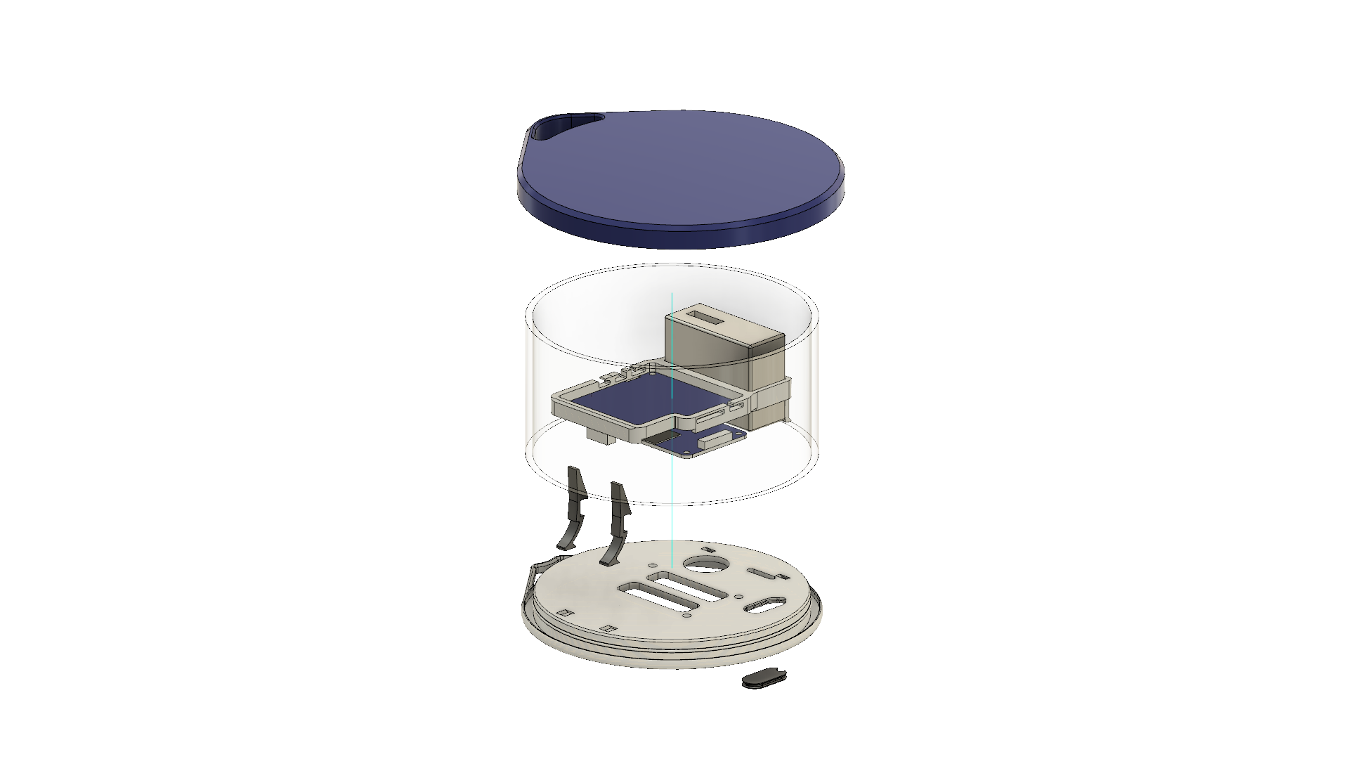

This enclosure is a mixed solution with 3D printed components and commercial parts (PMMA-Acrylic pipe). The top lid can be either milled or printed.

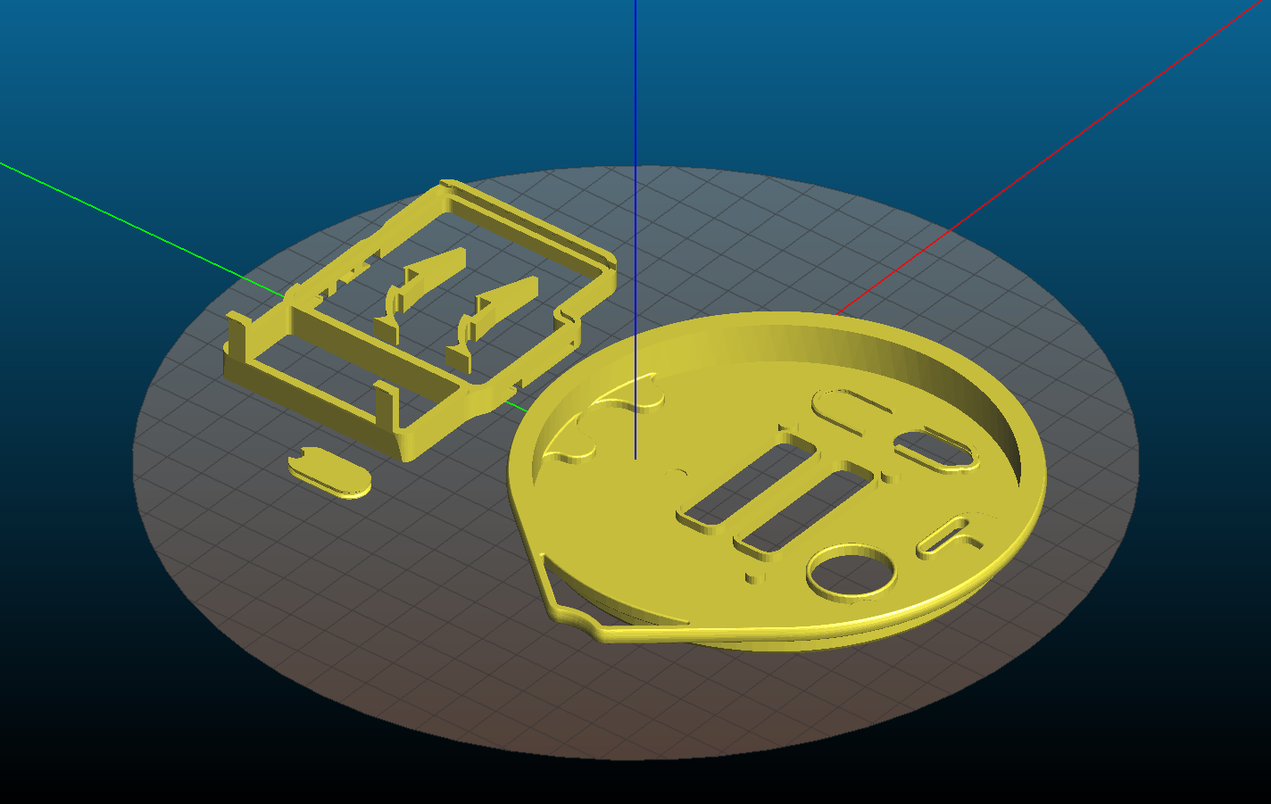

Printing settings¶
We have tested the 3D printed components with both PLA or ABS. Good results are achieved with a normal 0.4mm nozzle and 0.2 layer height. No raft or brim are needed.
Clip¶
The SCK and the PMS5003 are held together by a 3D printed clip. No support is needed for this part.
Base¶
Support is needed for this part and two versions are provided (with and without support in the STL file).
Locks¶
Flexible locks are also provided for better fixation. No support is needed.
Cable gland¶
A small cable gland is also design to help improve waterproofness and fix the USB cable. It can be stored in the pocket next to the opening.
Top lid¶
This part can be milled or printed. Same settings apply for this part, and the milling details are specifies in the milled solution section.
