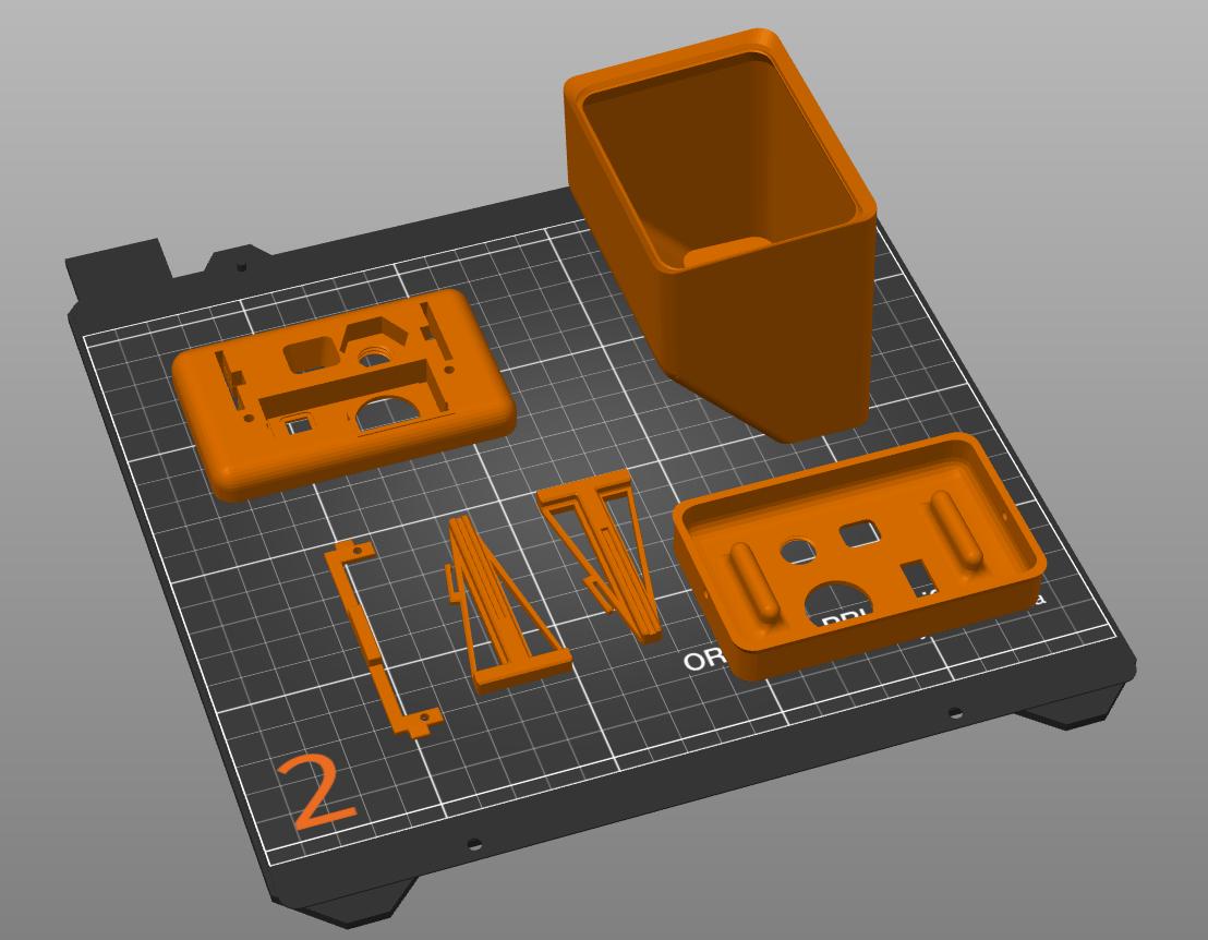

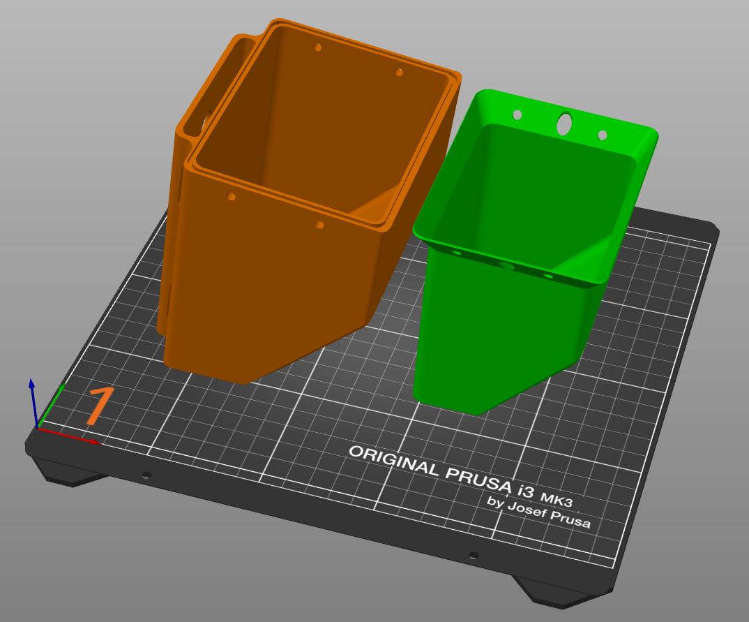

We have tested this on a Prusa MK3 3D printer, using PLA and PETG using the following settings:
- No supports
- 0.2mm layer height
- At least 3 vertical walls
- When printing PETG is better doing it in a closed printer to avoid warping
See the slicer capture below:
